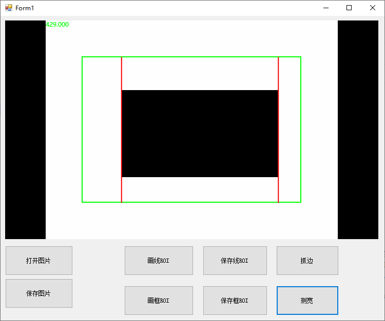

先新建一个Winform项目,界面设计如下:
注:项目的解决方案平台不能使用AnyCPU,只能根据安装的Halcon位数选择x64x86,我使用的是x64平台。

在窗体类中定义一个HDrawingObject对象并附加到现有窗口用于交互,同时定义好Line对象、Rectangle2对象用于保存绘图的结果。
先在图像窗口上面画出线和框,然后再用鼠标手动调整大小、位置,代码如下:
//绘图对象
private HDrawingObject drawingObject = new HDrawingObject();
//线ROI
private Line line = new Line();
//框ROI
private Rectangle2 rectangle2 = new Rectangle2();

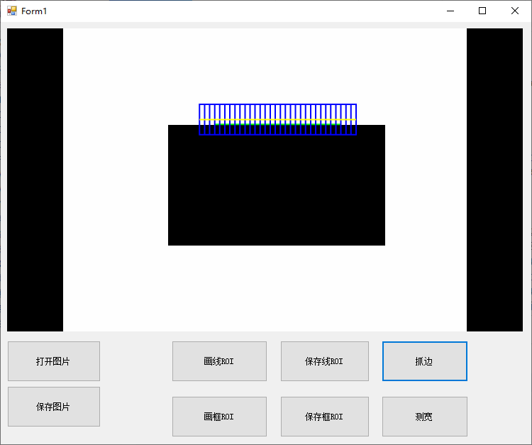

代码实现
抓变算法的C#代码如下:
private void button_FindEdge_Click(object sender, EventArgs e)
    //创建测量对象
    HMetrologyModel hMetrologyModely = new HMetrologyModel();
    //设置图片大小
    image.GetImageSize(out int width, out int height);
    hMetrologyModely.SetMetrologyModelImageSize(width, height);
    //添加直线测量
    double measureLength1= 30, measureLength2=30, measureSigma=1, measureThreshold=30;
    HTuple genParamName = new HTuple(), genParamValue = new HTuple();
    hMetrologyModely.AddMetrologyObjectLineMeasure(line.Row1, line.Column1,line.Row2, line.Column2, measureLength1, measureLength2, measureSigma, measureThreshold, genParamName, genParamValue);
    //执行并获取结果
    hMetrologyModely.ApplyMetrologyModel(image);
    //获取测量区域
    HTuple mRow = new HTuple(), mCol = new HTuple();
    HXLDCont mContours = hMetrologyModely.GetMetrologyObjectMeasures("all""all"out mRow, out mCol); //检测区域轮廓
    HXLDCont mmContours = hMetrologyModely.GetMetrologyObjectModelContour("all"1);    //测量对象轮廓
    //参数顺序 ["row_begin", "column_begin", "row_end", "column_end"]
    HTuple  lineRet =hMetrologyModely.GetMetrologyObjectResult("all""all""result_type""all_param");
    double[] retAry = lineRet.DArr;
    //打印结果
    hwindow.SetLineWidth(2);
    hwindow.SetColor("green");
    hwindow.DispLine(retAry[0], retAry[1], retAry[2], retAry[3]);
    hwindow.SetColor("blue");
    hwindow.DispXld(mContours);
    hwindow.SetColor("yellow");
    hwindow.DispXld(mmContours);
    //清空测量对象
    hMetrologyModely.ClearMetrologyModel();
    //清理对象
    hMetrologyModely?.Dispose();
    genParamName?.Dispose();
    genParamValue?.Dispose();
    mRow.Dispose();
    mCol.Dispose();
    mContours.Dispose();
    mmContours.Dispose();

使用方法
直接在界面上点击“打开图片”->“画线ROI”(默认位置我都调好了,你也可以自己调整大小、位置)->“抓边”,过程如下:
测宽算法

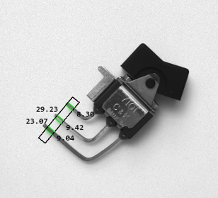

测宽算法使用一维测量中的measure_pairs算子提取直边对,然后计算两个直边的距离。代码太长这里就不贴了,完整的项目源码会在文章末尾给出。
需要注意,measure_pairs算子的搜索框必须和目标边缘完全垂直,否则宽度数据会不准确,算子原理如下:
直接在界面上点击“打开图片”->“画框ROI”(默认位置我都调好了,你也可以自己调整大小、位置)->“测宽”,过程如下:
上面的箭头就是框的方向,测量边必须与框的方向接近垂直否则会运算失败,实际项目中还是建议用2D测量单独抓两个边来测宽度。
