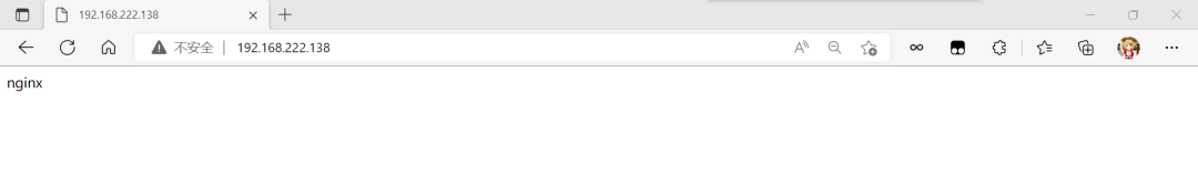

Web2:
[root@Web2 ~]# yum -y install nginx  //下载服务
[root@Web2 ~]# systemctl stop firewalld.service //关闭防火墙
[root@Web2 ~]# vim /etc/selinux/config
SELINUX=disabled
[root@Web2 ~]# setenforce 0
[root@Web2 ~]# systemctl disable --now firewalld.service
Removed /etc/systemd/system/multi-user.target.wants/firewalld.service.
Removed /etc/systemd/system/dbus-org.fedoraproject.FirewallD1.service.
[root@Web2 ~]# cd /usr/share/nginx/html/
[root@Web2 html]# ls
[root@Web2 html]# echo "nginx" > index.html  //编辑内容到网站里面
[root@Web2 html]# cat index.html
nginx
[root@Web2 html]# systemctl enable --now nginx.service
Created symlink /etc/systemd/system/multi-user.target.wants/nginx.service → /usr/lib/systemd/system/nginx.service.
[root@Web2 html]# ss -antl
State      Recv-Q     Send-Q          Local Address:Port           Peer Address:Port     Process
LISTEN     01280.0.0.0:1110.0.0.0:*
LISTEN     01280.0.0.0:800.0.0.0:*
LISTEN     032192.168.122.1:530.0.0.0:*
LISTEN     01280.0.0.0:220.0.0.0:*
LISTEN     0128                      [::]:111                    [::]:*
LISTEN     0128                      [::]:80                     [::]:*
LISTEN     0128                      [::]:22                     [::]:*
访问:

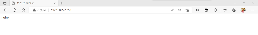

测试:
在浏览器输入nginx负载均衡器的IP地址

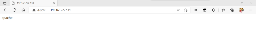

访问:
Web2:
SELINUX=disabled
nginx
访问:

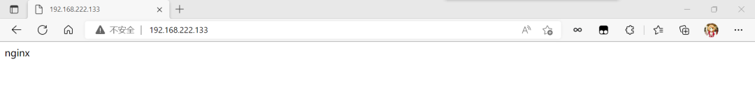

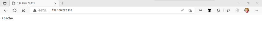

测试:

访问:
master:
[root@master keepalived]# curl 192.168.222.133
apache
nginx
此是关闭master上面的nginx和keepalived的
[root@master keepalived]# systemctl stop nginx.service
[root@master keepalived]# systemctl stop keepalived.service
[root@master keepalived]# ip a
1: lo: <LOOPBACK,UP,LOWER_UP> mtu 65536 qdisc noqueue state UNKNOWNgroupdefault qlen 1000
    link/loopback 00:00:00:00:00:00 brd 00:00:00:00:00:00
    inet 127.0.0.1/8scope host lo
       valid_lft forever preferred_lft forever
    inet6 ::1/128scope host
2: ens33: <BROADCAST,MULTICAST,UP,LOWER_UP> mtu 1500 qdisc fq_codel state UP groupdefault qlen 1000
    link/ether 00:0c:29:05:f4:28 brd ff:ff:ff:ff:ff:ff
    inet 192.168.222.250/24 brd 192.168.222.255scopeglobal noprefixroute ens33
//此时master上面没有VIP
backup:
[root@backup keepalived]# systemctl enable --now keepalived
[root@backup keepalived]# systemctl start nginx.service
[root@backup keepalived]# ip a
    link/ether 00:0c:29:31:af:f9 brd ff:ff:ff:ff:ff:ff
    inet 192.168.222.139/24 brd 192.168.222.255scopeglobal noprefixroute ens33
    inet 192.168.222.133/32scopeglobal ens33
    inet6 fe80::20c:29ff:fe31:aff9/64scope link
//此时backup上面出现VIP,备节点变成了主节点
[root@backup keepalived]# curl 192.168.222.133
apache
nginx
访问:
可以看到,其中一个nginx负载均衡器挂掉了,也不会影响正常访问,这就是nginx负载均衡的高可用的配置

[root@master]# curl 192.168.222.133
nginx
apache
nginx
//此时VIP重新回到master上面
